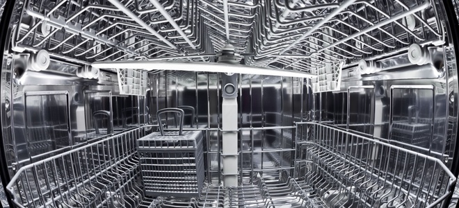

Step 2 - Examine the Drain
Your dishwasher drain is in the bottom of the machine and is usually protected by a plastic grill. The condition of the grill will indicate the state of the drain. If it has solid matter clinging to it, clean the grill by hand wearing rubber gloves. Be especially careful in case there are shards of glass. It is fairly certain that if the grill has accumulated debris, there will be a need to clean the rest of the drain.
