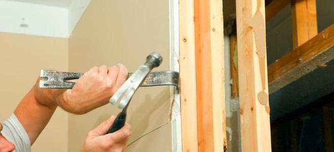

Step 4 – Removing the Drywall or Plaster
Warning: Before beginning demolition, put on the appropriate safety gear for each step of the project, including but not limited to a safety mask, eye goggles, and gloves.
Now, you can start opening up the wall. Remove the drywall or plaster carefully, looking for any utility items inside the wall. You might need to move electrical wires, vents, or pipes before you take the entire wall down. Use your hammer to punch out the drywall and the claw and a pry bar to remove it.
Taking Down Backed Plaster
The plaster can be hard, backed with metal or wood lathe. In this case, use your reciprocating saw with a demolition blade. Cut through the plaster and the lathe all at once, being careful not to go too deep and damage any utilities.

Step 6 – Taking Down the Studs
When all the drywall or plaster is removed and you’ve taken care of utility issues, you can then remove the vertical wall studs with a reciprocating saw. Be sure to have someone else holds the stud. Also, make sure the blade in your saw is capable of cutting through nails. You may have to twist the studs to get them to come loose. Cut at the floor and ceiling plates that encase the wall studs, removing any nails from the ceiling or floor where the wall originally was.
