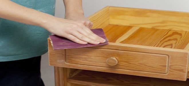

Sand the Door with Fine Grit Sandpaper
Use fine to medium grit sandpaper and carefully sand the entire surface of the door, including the sides and any grooves to completely remove any existing paint or varnish on the door. Brush off the surface to remove the residue.
Paint the Door
Paint the door in white or any neutral color with a sponge roller, working in one direction and using even strokes. Allow one coat to dry before applying another coat. Leave the door to dry overnight.
Sand the Door with Medium Grit Sandpaper
Once the cabinet door is thoroughly dry, use medium-grit sandpaper, with grit between 90 and 120 to sand away the paint on the parts of the door that would normally show signs of aging and wear, as if you had owned it for years. These can include corners, edges, areas around the handles and hinges, or any other hardware, and any part you feel may rub or hit against objects when it is opened or closed. Stop sanding the door when the wood beneath the paint is visible and brush or wipe the surface to remove any residue.
