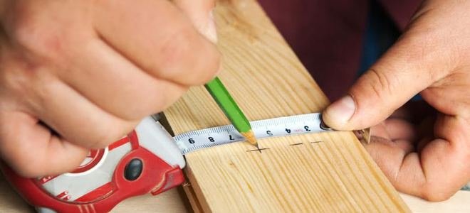

Step 1 - Mark Your Carport
Mark out the carport roughly in a rectangle measuring 10 feet wide by 20 feet long. Put up a wood profile from each corner and in the middle of each side to create a base. The two center posts will do the bulk of the work in holding the carport up. Each corner post needs to be a 4x4 board with the center posts having the same thickness. This will give the car port durability as well as stability.
This carport will be anchored into the ground with anchoring lines extending from the canopy. Since you will not be digging holes into the ground for each post it can be moved around to your desired location easily. Each corner post needs to have a height of nine feet as well, allowing for plenty of room to get your car underneath it.
