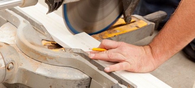

This is the easiest piece of trim to cut, as well as the most forgiving. It is also a great way to practice with angle and miter cuts. Baseboards are usually 1x4-inch stock, or some other wide board, so you don't have to worry about small intricate cuts.
Step 1
Measure the length of the area to place trim. Measure the wood, marking the place for your miter cut.
Step 2
Hold the piece of wood up against the miter fence and make the cut.
Step 3
Measure other side of wall by going past the corner to the outside edge of the trim molding. Mark this on the wood.
Step 4
Cut with the piece standing flat against the miter saw fence.
