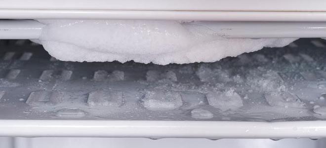

Defrosting a freezer may not be one of the most glamorous tasks, but it’s one that must occasionally be done. As the freezer is opened and shut over time, warm air enters the freezer, condenses, and freezes inside the unit. This causes a buildup of frost that not only takes up space in the freezer, but decreases the efficiency of the appliance. If you notice frost buildup that's more than 1/4-inch thick, it's time to defrost your chest freezer. If your home has a large chest freezer, perhaps in a basement or garage, you may be wondering how to carry out this process. Luckily, it’s easy to do. Keep these steps in mind the next time you need to defrost your chest freezer.
