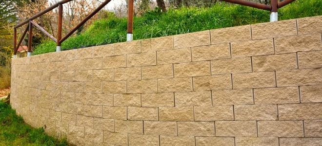

Rock retaining wall
Several variables factor into the structural design of a retaining wall. The grade differential and the mechanical properties of the soil behind and below the retaining wall create the primary forces. Determining the elevation of the water table and the location of the frost line are necessary elements in the design of most retaining walls. The presence of ground water will introduce complicated loadings on the retaining wall and can affect the fluid and soil mechanics of the earth bearing the wall’s footing.
A retaining wall is likely to fail in one of several ways. The structural integrity of the wall can be compromised by cracks or ruptures. The entire wall can topple over, or it can slide forward in an upright position. If the base of the wall is pushed outward by flowing groundwater, it is referred to as undermining.
