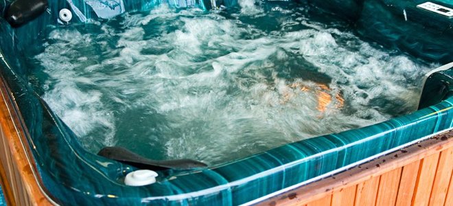

From time to time, you will need to perform a tub drain on your hot tub or spa. The tub will need to be drained and cleaned periodically, especially if you are not using it during the winter. Whatever the reason, draining your tub is important to know how to do. If you leave it too long, bacteria can form in the standing water. In particular, winter maintenance is vital to ensure your hot tub won’t sustain any damage when the weather turns cold.
