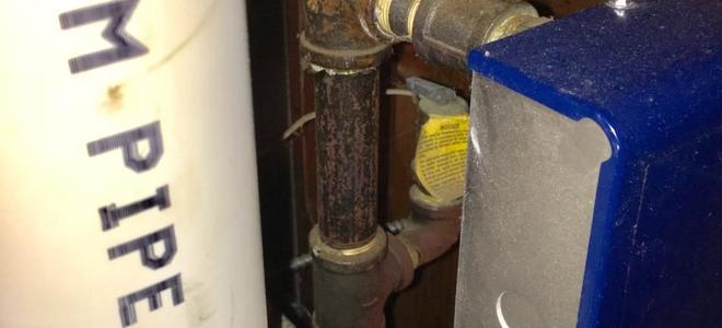

Emptying the system first requires you to turn off the heating. Initially, you wouldn’t turn off the pump as you require the water to cool down. Each system has an expansion tank. When water is hot it expands and needs to be replenished as it cools down. This tank is usually found in the attic.
Turn off the water that is filling this tank. You will normally find a stop cock located somewhere near. This brings the water in from the mains and by turning it off you will stop the tank from refilling. Allow the water to completely cool down, and then drain the tank by opening the drain cock located on the return pipe to the boiler. Lead the water out of the drain cock with a hose pipe. This will stop your basement from being flooded provided you have properly attached it and placed the end of the hose into an exterior outlet. Once it is drained bleed each of the radiators starting from the highest down to the lowest.
