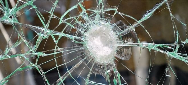

Learning how to drill glass without breaking it is very simple if the proper tools are at hand. It is important to have the right kind of drill bit for the glass. If you do not use the right drill, then you can be sure that the glass will crack or completely break. If possible it is best to not drill through glass though sometimes it is necessary.
Step 1 - Consider the type of Glass
Ensure the glass needed is the correct thickness and size. Safety glass and tempered glass should not be used. Very special equipment is needed for safety and tempered glass. This equipment is not available at the local hardware store.
