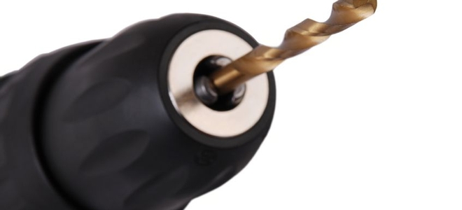

Use a regular drill bit and bore through the plastic directly above the marks on the back of the mirror. Drill slowly and do not drill any further than the plastic. These holes will guide you as you begin to drill into the glass. Skip this step if you do not have plastic.
Drill the Glass
Exchange the regular drill bit for the diamond drill bit. Using the regular drill bit on the glass will only dull it, and you will also be more likely to damage the glass. Next, place the drill above the glass, inside the holes through the plastic. The drill should be held at a 90-degree angle with the surface. Then, slowly begin drilling into the glass at a constant speed and with light pressure.
