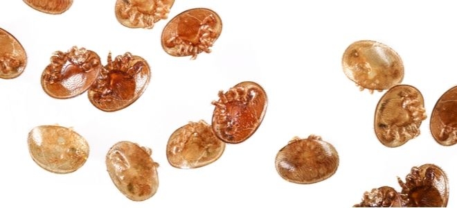

Varroa mites have become a major concern for beekeepers. These tiny insects look like miniature ticks—they live by attaching themselves to bees and draining their blood, leading to the death of their hosts. The mites spread extremely fast and may lead to massive hive losses if left unchecked.
Controlling these insects is very difficult—most insecticides used to eliminate them can also wipe out bees and poison their honey. Thankfully, bee farmers have a few helpful tips for managing varroa mites. Some of the methods in this guide are not conventional, but they've helped several farmers get rid of the invasive pests.
