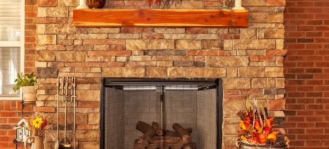

A wood mantel shelf is ideal to cap your fireplace mantel, adorning it with a decorative fixture, as well as providing a practical space for candelabras, books, photographs, or other keepsakes. Once you choose the style of mantel shelf you wish to install, it needs to be finished to both protect the wood from overexposure to air and moisture, as well as to decorate it. Opting for paint is one way to coat and adorn it. Depending on the decor of the room and the mantel itself, staining it may be a better choice of finishes. Natural wood stain comes in numerous colors, shades, and types. Glazing is another option: the process of combining stain or paint with a solvent to create a rustic look. Ultimately, though, how you finish the mantel shelf is a matter of personal taste and style coordination.
