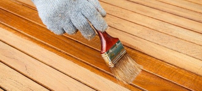

Step 3 - Stain
Put on a pair of rubber gloves and stir the stain. Use a sponge, brush, rag, or cloth to apply the stain to the wood. Be generous with the amount of stain you use. Follow the natural grain of the wood in one motion. Brush the whole bench as evenly as possible.
After applying the stain, wait five to 15 minutes for the color to absorb into the wood. If you want a darker color, wait a longer period of time. It's better to add less stain at first and then add more if you want a darker color.
After you've completed staining, set the bench down on a flat area and let it dry for six to eight hours.
