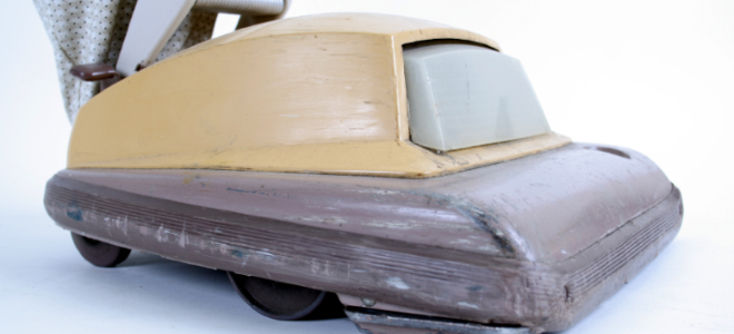

When a vacuum cleaner and the vacuum brush attached to it are working properly, the vacuum cleaner is arguably the most effective way to clean a carpet. Since it is such a hard-working machine, there is always required maintenance and room for malfunctions. The fact is, the most common reason for vacuum cleaner failure is a roller brush in the vacuum that is not turning properly. To fix your vacuum brush roller, follow these five steps.
