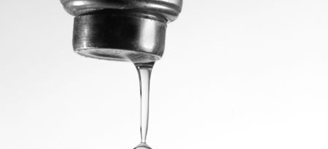

How to Fix a Leaky Ball-Style Faucet
A large water drop falls from a leaking faucet.

Water faucet leaks can be annoying to say the least, but they can also cause corrosion on fixtures if relentless dripping goes unrepaired. Cheaper builders’ grade faucets are generally ball style spigots which feature a ball joint that is rocked back and forth for hot or cold water. With ball-style spigots, the usual culprit for a leaky faucet is the inlet seat spring. These springs will lose their tension over time and start to wear and compress. Although they are not as prone to leaks as compression faucets, leaks can happen due to sediment buildup and worn springs and seals.
