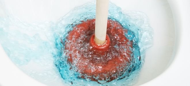

Failure for waste to clear your toilet is a common problem as a result of a low flow toilet. You will notice that the flush is slow, and everything does not go down. Then you have to wait until the tank is filled and flush it again. It can be gross and frustrating. A low flow toilet is usually caused by the handle linkage being too long or a warped flapper valve that can easily be fixed.
