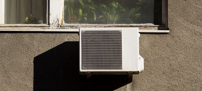

Window air conditioners at times just refuse to turn on. In most cases, the problem is a minor one and can be taken care of at home without getting professional help. A little general knowledge about window air conditioners will help you to understand and rectify the associated problems in a better way.
So, before you toss your old AC unit or call a repairman, check these five common problem areas and give DIY repairs a try.

Check the air conditioner as a whole to see if it is plagued with the debris or plant growth. A window air conditioner needs to circulate air, and if debris like grass or other objects get sucked in, the capacitor can be damaged, and in extreme cases, the air conditioner can also be blown. So, clear the debris and other vegetation growing around the air conditioner.
