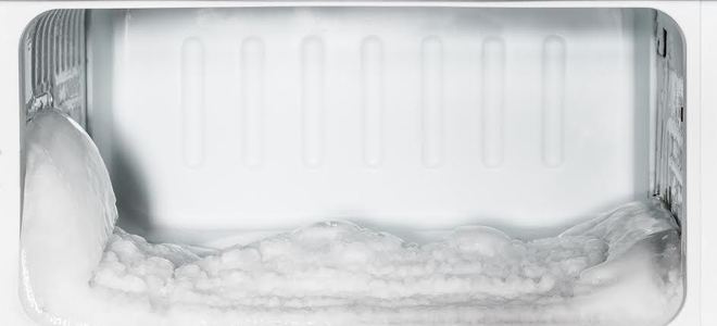

Step 3 - Defrost the Freezer
If the freezer isn’t getting cold enough, try defrosting the unit. Units not supplied with an automatic defrost unit need occasional defrosting to maintain proper temperatures. Also, check to make sure the temperature is correct.
Furthermore, check to see if the door has been properly closed or closes properly. Sometimes a carelessly stored item keeps a freezer door from closing properly, affecting the overall operation.
