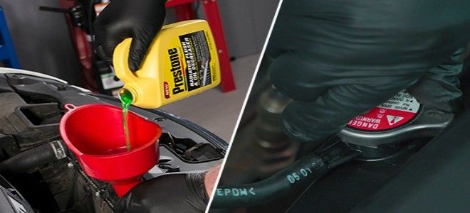

Step 13 - Add New Antifreeze
It is generally recommended to use pre-mixed antifreeze when performing a flush and fill because you do not have to worry about mixing it yourself. You can find pre-mixed coolant at your local O’Reilly Auto Parts store. If you want to use full strength antifreeze, you will need to add water to the coolant at a 50/50 ratio. Once the coolant is added, make sure all the caps have been tightened into place.
Step 14 - Startup
With the new coolant added, start the engine. Let your vehicle run for another 10 minutes after it has reached normal temperatures. Watch for any leaks under the car while it is running.
