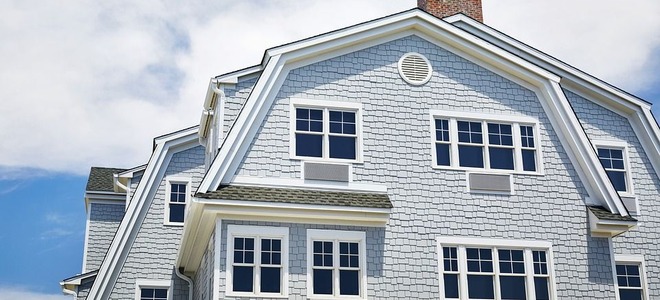

If you are planning at home addition project, you will need to look at roofs. There are a number of different styles and types of roofs. One of the best uses of space is the gambrel roof. A gambrel roof is similar to a hip roof but it actually has gables at either side.
Gambrel roofs are the sort of things that you will see on many barns because they make the best use of all the space available. Very little space is wasted in the pitch of the roof because the gambrel roof addition is so wide. Fitting your own gambrel roof addition to your barn or home isn't that complicated. As long as you follow a few simple steps you shouldn't have any problem doing this.
