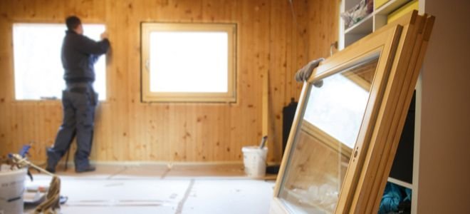

Whether you're building a new home, removing an older window frame, or adding a new one in an existing wall, there are a few core elements to framing a window. It's a big project, but it only takes a few tools and materials, so you can definitely pull it off. You'll probably start with some demolition if you don't already have an opening. Here's what to do next.
