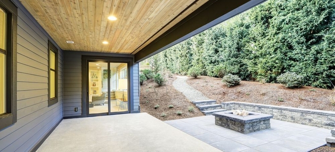

If you are renovating your backyard, it may be necessary for you to learn how to frame concrete patios. Since we are only discussing how to actually frame the patio here, we will leave the mechanics of how to buy, mix, and pour your concrete for another day.
Step 1 - Plan
There is a significant amount of planning that must precede the actual pouring of concrete when constructing a patio. First and foremost, you will need to determine how big you would like your patio to be, and its exact shape. Using some sort of marking device (flags or spray painted lines are popular choices), mark off the area where you would like your patio to eventually be installed.
