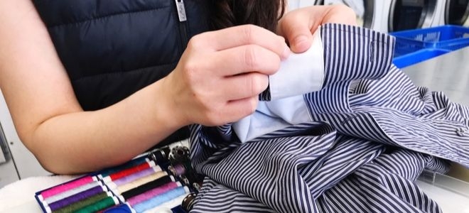

Step 1 - Anchor Lining
Place your thimble on your middle finger. Once the lining has been attached to the fabric, anchor your thread to the right-hand edge of the fabric with the lining side facing you. Bring up the needle and thread at a point 1/4" to 1/8" from the top edge of the fabric.
Step 2 - Use the Needle
Insert the needle back into the fabric at a point 1/4" to 1/8" from the point above where you brought up the needle. The needle should pierce the lining and all of the allowances for the seam but should not penetrate the fabric on the outside. Bring the needle out at a point 1/4" to 1/8" from the point where you penetrated the fabric.
Step 3 - Repeat
Repeat going from right to left across the fabric in a straight line until you have finished. When you are finished the lining should be firmly attached but no stitches should show on the outside of the fabric. To help you keep a straight line, you can mark a straight line across the lining with a water-soluble marker. Because you are essentially pricking the outside fabric without penetrating it on every stitch, this is known as a prick stitch.
