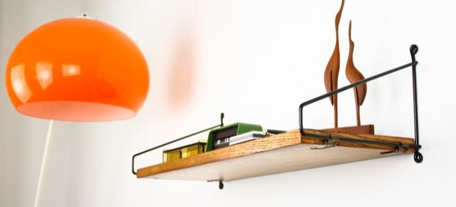

There are many options for mounting a decorative shelf to a wall. Among these are direct mounts (using self-contained shelves that come with mounting hardware) and the use of decorative wall brackets to support a shelf that is just a piece of wood, melamine, glass, etc.
NOTE: The methods below require drilling holes in the wall, so may not be suitable for weak walls or for those who rent.
Direct Mount
For shelves meant to hold heavier objects, or for nubbly walls, attach the shelf with screws. Most modern self-contained wall mounted shelf units come with a slotted metal plate on the back and some screws and anchors.
Step 1 - Gather your Supplies
Bring together all your supplies, including a step ladder if needed so you can complete the task without running back and forth to the toolbox.
Step 2 - Install the Screws
wooden shelf with basket on top
If one of your screws is going into a wood stud inside the wall, it won't need an anchor. Mark where the screws will go (accuracy is important!), put a piece of tape on the wall to protect it, and pre-drill using the smaller drill bit. Screw the screw into the wall so it protrudes about the thickness of the metal plate. If there is no stud, use an anchor. Mark and tape as before, then drill a hole with the recommended drill bit. Insert the anchor and gently tap with the hammer until it's in (you may just be able to push it in with your thumb). Insert the screw into the anchor and screw it into the thickness of the metal plate. Remove the tape.
Step 3 - Mount the Shelf
Line the larger end of the slots up with the screw heads and slide the slot over the screw. Let the shelf slide downwards until the smaller end of the slots rest on the screws. If the shelf is at all wobbly, remove the shelf and screw the screws in a little further. The shelf should rest firmly on the wall without wobbling.
