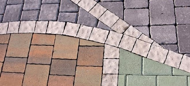

The cobblestone paver is a great way to add some character and definition to your garden and walkway. Cobblestones have been in use for centuries as a building material for roads and walkways around the world. They last for a very long time and do not require a lot of maintenance. Installing a cobblestone paver walkway is challenging in that there is a lot of labor involved. In some instances, especially if you are installing a long walkway, the help of a few friends makes this project a lot easier.

Step 5 - Install Cobblestone Pavers
Starting at the bottom of your walkway, begin to lay out the cobblestone pavers. Start in the center of the walkway and work out from there. You should not have many instances where you need to cut any of the pavers. If you do, use a chisel to score the paver. Break it off with a hammer. Continue installing the pavers until the walkway is completed.
Step 6 - Spread out Sand
To cement the pavers in place you will be using sand. Spread out more sand over the top of the pavers. Sweep it into the cracks and crevices. Use the compactor again to make sure that it is all level and stable. The cobblestone pavers will last for many years this way.
