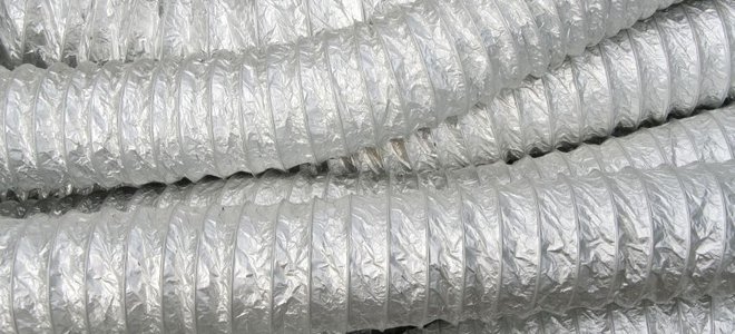

A damper can control the flow of air in your ducts, changing the output to different levels of your home or different rooms as needed. In this way, you can better regulate the temperature, especially between summer and winter months. Do be mindful when you add a damper, though, as your home’s duct system should already have been designed with air flow for the entire home in mind, especially in newer homes. However, it is not too difficult to install an inline damper, and below are some step-by-step instructions you can follow to add one yourself.

Look at your furnace and at the ductwork to figure out the best place for the installation. If you wish to put the damper on the upstairs line, then you will need to put the damper at the beginning of the duct.
Step 4 – Measure
After you determine where the duct is and where you wish to install the damper, measure the diameter of the duct. You will need the same size damper for it to fit properly.
Step 5 – Install Damper
Open up the duct work, and drill two holes on opposite edges of the tube. These holes should line up with the pre-drilled holes on the damper. Remove the fasteners from the damper, connect it to the duct through these holes and into the drilled holes, and tighten. Then, seal both sides with duct tape.
