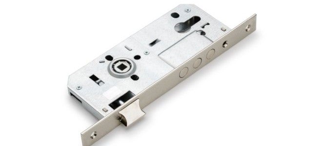

A flush door bolt is a particular type of door bolt that is installed in a way that it is even with the door side. When considering installing a flush door bolt, take note that there are two types to choose from – manual and automatic. Manual flush door bolts require someone to lock and unlock it. The automatic version will open automatically when opening the door and closes when the door is closed. When installing a flush door bolt, one is to be positioned at the top of the door, and one at the bottom. The middle can be installed with a dead bolt. Below are instructions on flush door bolt installation.
