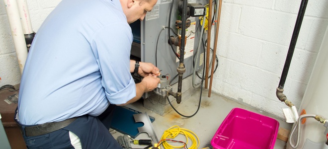

Installing a furnace blower motor is not a very easy task, but it is not an impossible one either. There are times when you will need to install a new motor for your furnace. Motors eventually get worn out and should be replaced. You can buy the new motor from a furnace repair shop or you can search online and buy it. Many dealers have online stores and will also deliver the motor to your home. With the right set of tools and this guide, you can install the furnace blower motor and save money.

Connect the furnace fan to the power outlet and turn on the mains from the main panel. Turn on the furnace fan and check the fan. It should be running smoothly. You can set the thermostat and let the furnace run for a while, but a few minutes would suffice.
