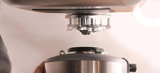

Step 10 - Hang the Disposer
All Evolution models install similarly. Hang the disposer by aligning the three mounting tabs with the slide-up ramps on the mounting ring. Holding the disposer in place, turn the lower mounting ring until all three tabs are locked into the mounting assembly. The disposer will now hang by itself.
