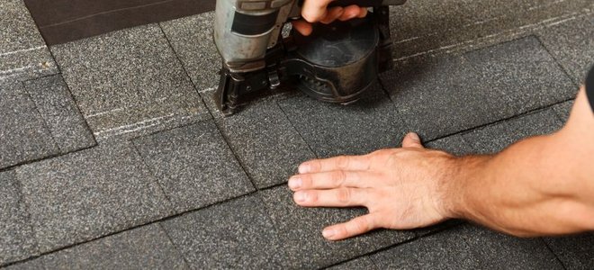

Once you have the roof cap purchased you can begin the installation process. Measure both sides of the ridge line to six inches below the line. With the measurement marked, run a chalk line along the roof at this six-inch mark and snap the line. Do this for both sides.
Step 3 - Place First Shingle for Roof Cap
If using individual shingles for the roof cap, then start at the outside edge of the roof and lay down the first shingle. Lay the shingle so that it lies on both sides of the roof down to the chalk line. It should also be overlapping the last row of shingles by two to three inches. Secure it to the roof with a roofing nail two inches below the ridge line and just above the tar line.
Step 4 - Place Second Shingle
The next shingle is laid over the first with the edge just covering the glue strip on the first. Nail it with the roofing nails in the same way that you did the first.
Step 5 - Continue Installing Roof Cap
Using the same process as with the first two shingles, complete installing the roof cap in order to complete the roof.
