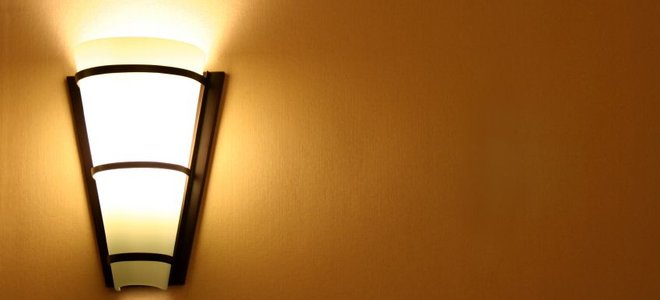

Not only are there endless sconce design options, but these fixtures also give off a dim light that makes rooms seem larger than they actually are. Have one in your bathroom and stylize the cover for a night light, or put one in your bedroom for intimate ambiance. To install one of the popular fixtures, follow these steps.
