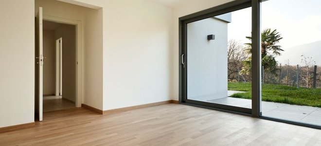

Installing a sliding glass door yourself helps save on the costs of a professional installation. If you are replacing an old one with a new one, you will have to remove the old door and prepare the opening for installation. If you are installing a new door, you should cut out the opening. You will need the help of a professional carpenter for this.

Step 3 - Install the Frame
Lay the frame down on the ground in front of the opening and apply lots of silicone caulk at the bottom of the frame as well as to the nailing flanges. Now slowly lift the frame and set it into the opening. Once in place, use a nail on the top right side of the frame to secure the door. Before you drive in the second nail, check the plumb of the frame using a level. Your second nail should be positioned on the bottom left side of the frame. Once you are sure of the plumb and square of frame, nail the flanges. You can make adjustments by pushing the bottom flange to the left or right to ensure squareness. Begin pushing in the wood shims, and keep a level handy.
Step 4 - Install the Door
Once the frame has been installed, installing the rest of the door is relatively simple. Check the side jambs, and if it is all good, hammer in all the nails. Do remember to apply caulk on any holes that you drill, especially on the underside, to ensure that your door remains waterproof. Fit in the rollers and insert the doors into the frame on the rollers. Do check if the doors are moving freely and correctly. If not, the height of the rollers may have to be adjusted. Lastly, install the locking mechanism.
