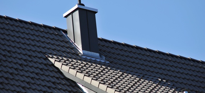

stainless steel chimney on a roof
Lower the support bucket in from above, and have someone else below to hold it in place. Use a few nails to start the bucket, then once you're sure that it's even, fill the rest of the provided nail holes. Install a trim plate on the ceiling by attaching it to the framing with screws.
Step 4 - Install the Flashing
Line up the center of the flue to the roof where the chimney will go by using a level. Drill a small hole in the roof at the center of this mark, to insure the chimney is lined up properly. Using proper safety equipment, go on the roof. Place the chimney flashing center on the hole. Mark the shape of the hole, then use the reciprocating saw to cut through the roof. Install the flashing, using the caulk to make sure the seal is strong and leak-proof. Replace shingles around the flashing.
Step 5 - Install the Chimney
Install the piping from the bottom up, bringing it from the furnace or stove location, up through the support bucket, and finally up through the flashing. Install the chimney top according to the manufacturer's specifications. Don't forget to put a storm collar around the base of the chimney to stabilize it and prevent leaks. Use caulk to seal all of the external connections. Make sure that all connections are tight and solid, and double check them at completion of this project.
