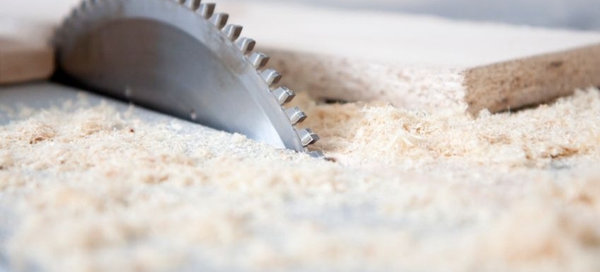

Step 2 – Cut the Wood
Transfer the measurements to the lumber and then cut them out. Cut out one for each side of the frame. Each piece will be the height of the door and the same width as the frame.
Cutting for the Knob
Set the pieces in place, and check that there is adequate clearance for the knob. Measure the distance for the knob, and cut another two pieces until the doorknob is safely cleared. When you’re finished, sand down the rough edges of the cut wood for a clean look.
