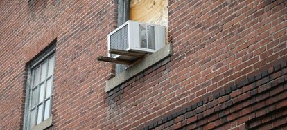

How to Install a Window Air Conditioner in a Sliding Window
Again, start by recruiting a friend to help. Open the window and lift the unit into place. Window air conditioning units are really meant for double-hung windows. You can skirt this possible obstacle by cutting a board to fill the space above the air conditioning unit.
Never install a window air conditioner vertically, thinking it will make better use of space. You can damage the unit by doing this.
Carefully measure the opening. Then use those measurements to precisely cut a piece of plywood to size. Fit it into place with the unit below it.
A huge piece of plywood is an eyesore and blocks your view out the window. If this is a problem for you, you can build a basic frame for a piece of plexiglass. Once in place, the unit will allow light to filter through while still filling the gap.
With your AC window unit and plywood in place, close the sliding window as far as you can. Then wedge the window into place with a block of wood in the runner to keep it from opening.
