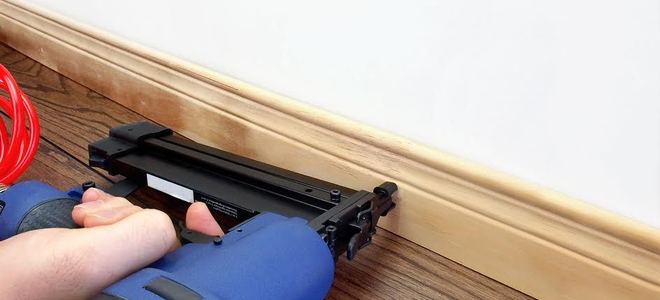

Step 8 – Fastening the Baseboard Pieces
Now, each of the pieces has to be fastened to the wall. Use a nail gun that is compatible with the 1 3/4 inch nails. As you have a piece ready to be nailed, prepare the next one for nailing. This may require you to trim some of the piece to get an exact fit.
