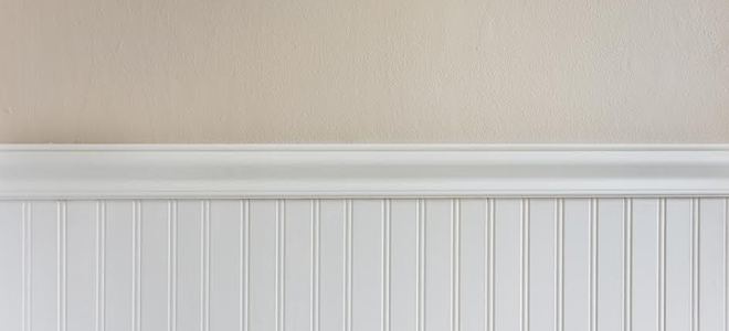

White wainscoting against a beige wall.

Installing beadboard, also referred to as wainscoting, is a great way to add a little decorative flare to a room, but it also helps protect walls in high traffic areas, such as hallways or pantries. Although installing beadboard may seem like a daunting task, it's a fairly straightforward process that the average DIYer can knock out in a few hours. Here are seven easy steps on how to install beadboard in your home.

Use a laser level to draw a chalk line for the desired height of the boards. If you do not have a laser level, you can measure equal distances from the floor and use a level to install the beadboards correctly. It’s also a good idea to mark the locations of studs before you set the boards. You can find studs pretty easily by buying a stud finder at your local hardware store. With everything in place, start by applying a generous amount of glue on each panel and push them firmly into place. Make sure each piece is level and that you have enough clearance for the baseboards before nailing into the studs. Repeat this process until the all of the wainscoting is in place.
Step 6 - Install Molding
Molding should be installed on the top of the beadboard and around any outside corners. Use the same process as you did when installing the beadboards. Once the top molding is secure, install the baseboards with some glue and nails.
Step 7 - Finishing
The last step in installing beadboard is to caulk and paint. If you are installing the beadboard in a bathroom, you want to make sure all of the seams are properly caulked to prevent water from getting behind the boards and ruining the wall. After all the necessary caulking is finished, you can add wood filler to hide seams. Once that has dried, paint the beadboard to your desired color and allow time to dry.
