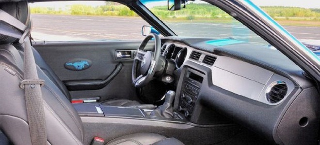

When your car dashboard covers get worn by sun and ultraviolet rays you may want to cover them with a smart new car dashboard cover to make them like new again. Dashboards get faded and worn by sun exposure and begin cracking and showing signs of age. Nothing makes your car look older or more dilapidated than a cracked and worn dashboard. This is when it’s time to haul out the new car dashboard covers and install it.

Step 1: Preparation
Make sure that the new dashboard covers will fit. To do this, place it over the existing dashboard monitoring the fit in all the right places as well as where you will have to make cutouts for the instruments, etc. As you are fitting it, check to see where you might need to adjust the covers to get a snug fit.
Step 2: Ensure the Fit by Adjusting
Before you start with setting the car dashboard covers in place make any necessary alterations to it; like cutting edges to set it in correct placement. Once you have made these alterations, check the fit again and sand off any rough edges remaining around your alterations.
