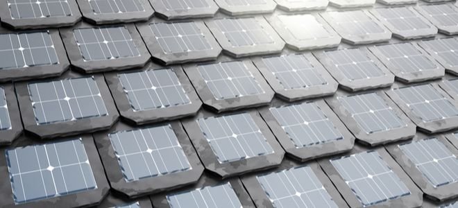

Composite roofing shingles are a superior product to use on your roof due to their durability and variety of both style and color. Although they may not last as long as copper or tile, they cost far less. Composite roofing shingles are the most common roofing material used today. When remodeling your roof, you will typically strip off the old shingles and tar paper and perhaps the plywood sheathing. After replacing the sheathing, you will finish the job with the bottom layer of tar paper, followed by the shingles, flashing and drip edges.
