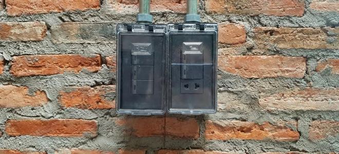

If you do any electrical work on your house, you’ll be installing electrical junction boxes. When you’re joining wires you need to use electrical junction boxes in order to comply with electrical codes. Never just connect wires with wire connectors outside a junction box. It’s not difficult to install electrical junction boxes. With just very basic electrical knowledge you can make a success of the job. Simply follow the instructions and you’ll see that it will all go very smoothly.
