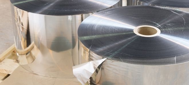

Flashing tape seals the seams of doors and windows. It is used to prevent any damage caused by moisture. This strong and durable tape can be used on most materials.
