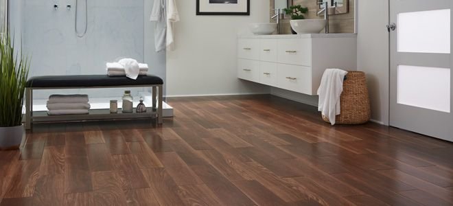

Walking on a cold bathroom floor is a harsh way to start the morning. While most people avoid cold feet by covering bathroom floors with enormous mats, radiant heating is a great way to keep the floor warm while increasing your home’s energy efficiency. Here is a quick guide on how to install heated bathroom flooring in your home without breaking your budget.
