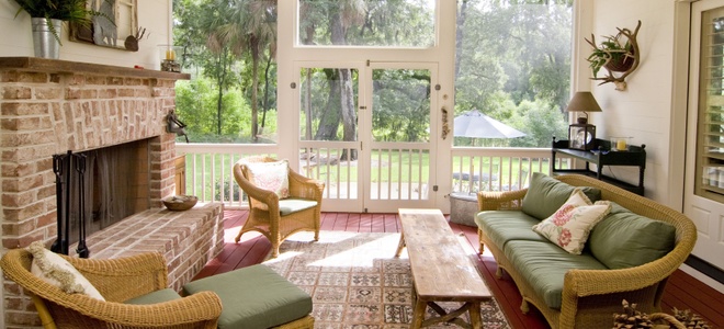

Wherever you want to enjoy outdoor living space, an outdoor carpet will provide a comfortable, soft flooring for your feet. An outdoor carpet can add great value to the outdoor living space as it provides a great finished quality and makes it more like an actual room than a place outside. Outdoor carpet comes in a wide variety of colors and textures.
