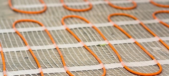

Step 1 - Measure the Radiant Heating Mats
Measure and make a plan of the floor to avoid all permanent fixtures and to avoid blocking the heated area as this will result in a build-up of localized heat and possibly damage the floor covering. If you’re not sure, discuss your requirements with the supplier, and they will calculate the amount of material you need.
They will even go over all the details of your layout, showing you where to cut and position the mesh for the best coverage and the easiest installation.

Step 4 - Spread Out the Radiant Heating Mats
pouring finish over radiant flooring
Use an ohmmeter before installation to make sure the circuit is working properly. Press the sticky side of the mat to the prepared insulated floor. It’s important to remember that the heat is carried through the thick red wire. Be careful not to cut or damage the red wire during installation; otherwise, the unit won't work. It’s not a big issue if the mat doesn’t cover every inch of the floor because the heat will radiate to other areas.
