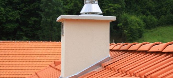

Whether you're building a new home and doing the roof yourself, or you're making a repair to an existing roof, flashing is something you'll need to install. It's not a difficult job, provided you're not afraid of heights that is, but it is a necessary one. Before we get into the details, however, let's examine what roof flashing is and where it fits into your roof so that you'll know exactly what and where you need to install it.
What Is Roof Flashing?
Roof flashing is a material used as a protectant against water leaks or seepage and is typically made of galvanized metal, but it can also be in the form of aluminum, sheet metal, copper, or even plastic. Galvanized metal or aluminum is considered the best to use for roof flashing. Aluminum is easiest to install due to how well it bends and is preferred by most DIYers.
Where Do You Install Roof Flashing?
As a protectant, flashing is placed anywhere on the roof's surface that requires extra protection. These areas include anywhere there are intersections or joints such as edges around chimneys, vents, skylights, roof valleys, and soil stacks. If you're having a leak issue in your home, you should first check these areas of the roof for any problems with the existing flashing. Oftentimes the nails have worked their way loose and the flashing has pulled away from the roof meaning it needs to be reattached. If it's in bad enough shape, replacement may be necessary.

Step Flashing for Chimneys
Once the shingles have been installed, lay the base flashing around the base of the chimney, approximately 4" past each end. Now, notch the first step flashing so that it will bend to go around the chimney front and side as well as at the base. Under the base part of the flashing, use plastic roofing cement and finish attaching it to the roof with galvanized roofing nails.
The top piece that bends around the chimney is left unattached. You continue this process around the length of the chimney, cutting each step flashing to fit. Counter flashing will then be wrapped around the entire chimney and attached with steel masonry fasteners (depending on your chimney flashing kit directions). Be sure to leave a 1-inch gap between your shingles and the bottom of the side flashing. Seal the top of the counter flashing and any gaps with plastic roofing cement.
