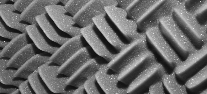

One way to soundproof your home is through adding soundproof panels. These panels are specially made to go under the drywall and over a backing of fiberglass insulation. If you have drywall already up, you need to remove it before beginning the project. Or if you don't want to remove the existing drywall and install the panels over it, skip Step 1. You will not need the fiberglass insulation. Measure the height of the wall and break it up into 16-inch increments. That will tell you how many strips of resilient channels you will need.
