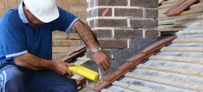

Step 1 - Corner Flashing
Step flashing is not a hard process for you to complete. In fact, it can save you money if you are having your roof reshingled. If you choose to rip off the existing shingles, you may want to tackle this as well. The first part of installing the step flashing is the installation of the corner flashing. You will start by snipping one of your pieces of step flashing at a forty five degree angle. You will want to place the lower portion of the step flashing against the roof and the other edge goes around the corner edge. Nail the piece of flashing in place and lay some caulk around the edges.

With the corner flashing installed, run the first row of shingles. After your shingles are laid down, begin to lay your step flashing. Place the next step of flashing approximately 1/4 inch above the next row of shingles, which will prevent the flashing from being seen. After you have laid down your first row of step flashing, you will continue this same process until you reach the top of the roof. You will not need the caulk until you begin installing the step flashing at the top of the roof, known as the roof peak.
