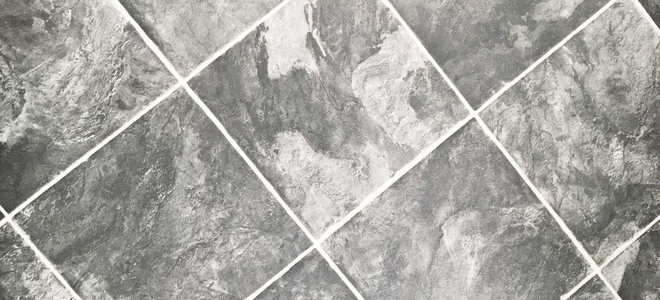

There are hundreds of designs and colors to choose from when installing vinyl tiles. The installation technique varies from one type to another. Below are the instructions for how to install self-adhering sticky tiles. If you are using dry adhesive tiles, the directions will be different.
