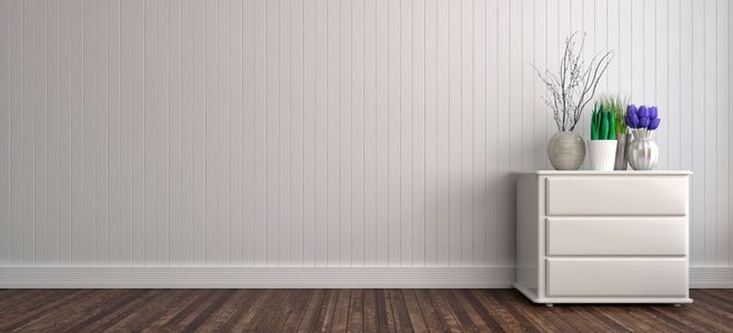

Wainscoting gives any space a high-end look, and that's why many people think it's a difficult DIY project. But installing wainscoting is a straightforward project when you have the right tools and methods.
